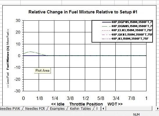

no, not at all. Checking the charts now, and there's only the slightest difference between 1172 and 1173 needles. Not even half a clip position worth. Running both needles in the same clip position and the 1172 has just a tiny bit more fuel flow from 0 - 3/16ths throttle. The peak of this increase is a bout 2% @ 1/16th throttle, tapering to 0% at 3/16th throttle. After that point the fuel curve is identical between the two needles all the way to WOT.

Yes, I know this. The kawi KDX needles are r1172n/r1173n. For these needles, the R11 is the taper, the 72/73 is the diameter, and the N is the L1 length.
R1173n needle is a equivalent to a keihin BGP, and the r1172n needle is equivalent to a BGN needle. A small change in diameter will only really affect fuel flow over the straight section of the needle, which is roughly 1/4 throttle or less.
Here's the relative fuel change when going from 1173n to 1172n needle, using same pilot/main and 5th clip position. As you can see, the difference is not what you might think it should be...
