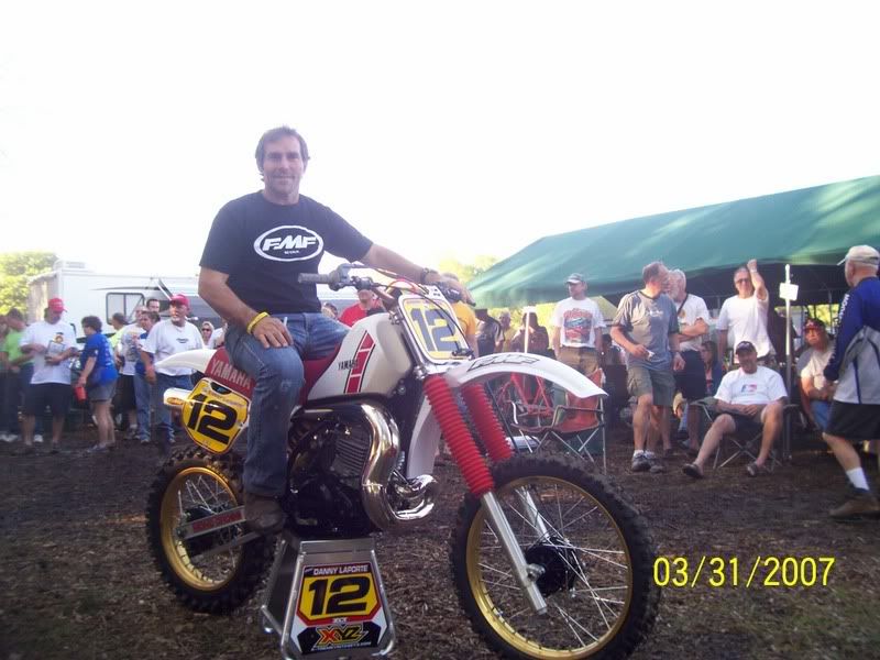

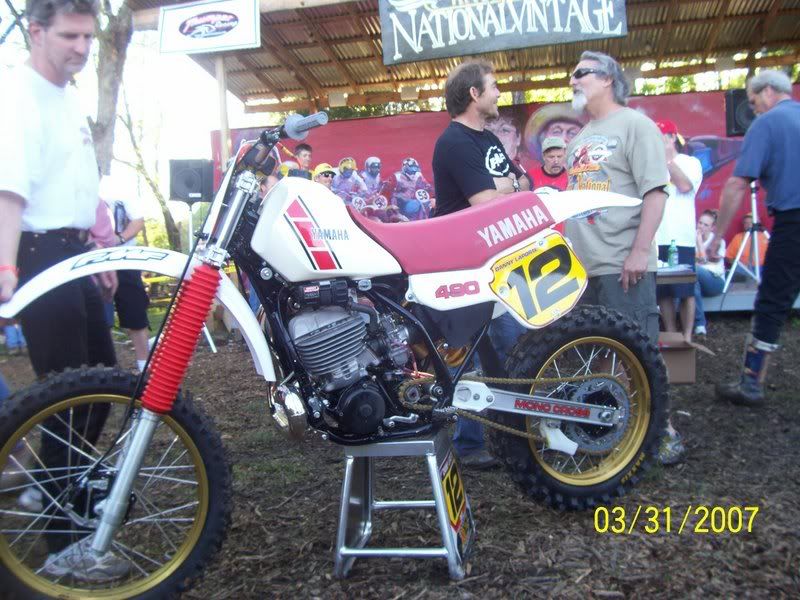

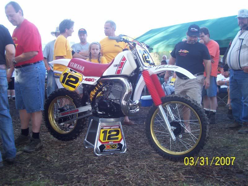

But I built another vintage bike for Danny Laporte so I thought I would show it off! I am building a replica of the YZ490 that Brad Lackey raced at the 83 Carlsbad G/P. He will ride it next season in the AHRMA national post-vintage series.
He says that he is the highest payed factory Yamaha rider ever, FOR ONE DAY!
Then I have to build one for Ron Lechien, its gonna be an 83 YZ 250 like the one he won his first SX race on.

That bike is actually more GO than show.
I sent the crank out and had it dynamically balanced.
Teddy Boyko ported the cylinder and did a head mod.
38 mm flat slide mikuni (venturi cut)
I drilled out all the motor mounts and put the next size larger bolts.
Billet clamps.
Race Tech donated the suspension.
But the transformation from a clapped out $500.00 craigslist bike to this is like the Phoenix rising.
The motor runs like you would not believe. When you rap on the throttle its a solid RRRRRRAAAAAAAPPPPPP! Not the pop, fart wheeze of the stocker! And the levers barely vibrate.
